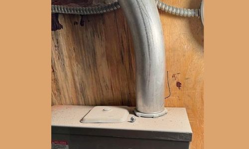

Hello I’m in NYC and I’ve been informed that the work to upgrade my electrical panel might be in violation of city code and was not performed with a permit.
Seeing as I’ve already paid 50% for the work, and not having an idea of what I’m looking at, I’m trying to ascertain if there is indeed a problem
The work is not done up to Coned and DOB National Code requirements There are no weatherproof fittings There is a custom-made knockout in meter pan enclosure Each new installation requires confirmation of the placement raintight weather head etc Connectors to the main line with unapproved bite connectors
Remember, Gas meter is not an electrical panel.
